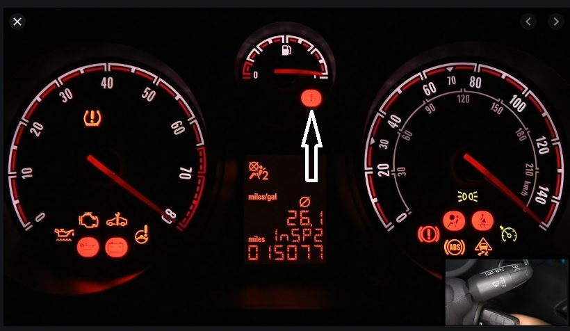

I waited for the wife in a supermarket car park earlier and left the engine running as i have been making a few short journeys lately she was away for at least 15 minutes and i never heard the fan kick in once, the fan on the 1.3 diesel i used to own would kick in regularly so i was a little concerned, for my peace of mind could someone tell me if the light arrowed is a temperature too high warning as i seem to have misplaced the book i got with the car.
This light has never illuminated so i assume the fan is working but its a lot quieter than the one on the diesel.

Yes that symbol is to indicate the car is overheating.
2) To get the temp guage up on the dash follow these steps: Press the button on the road the rest gjt drivers stalk ( press it 4 times and ON the 4 time hold it down until the screen changes - approx 15 secs. Then press the button another 5 to times to get temperature. (YouTube Corsa D hidden temperature guage - but it is 4 & then 5 presses do it every day).
3) If you still have coolant , then your overheating is coming from another component, most likely stuck thermostat, but could be water pump or faulty sensors.
4) Just read your post better.lol. For the light to illuminate it can.takenthe car to get really hot, usually damage is done once that light arrives. So simply run your car with temp guage up and see if fan kicks in, should be about 105c - 109c
