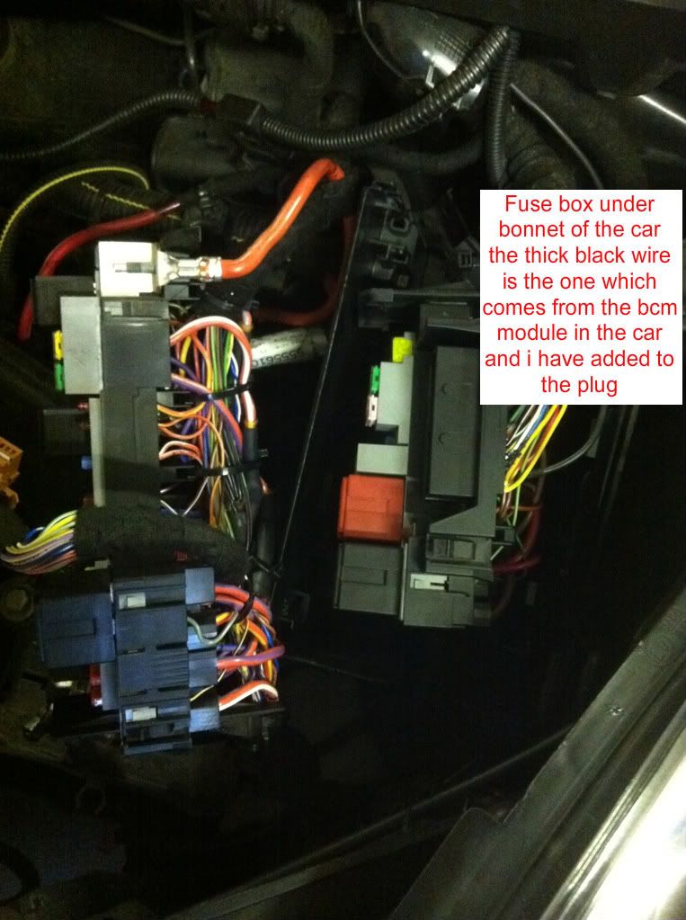

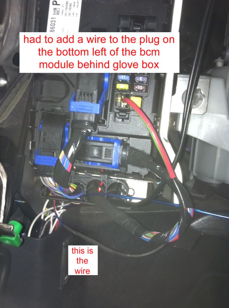

Well i thought i would have a go at fitting the missing wire from the bcm module behind the glove box to the fuse box under the bonnet so that i could get my fog lights to work, due to it being missing after i had it tech 2 and they told me it wouldnt work without it

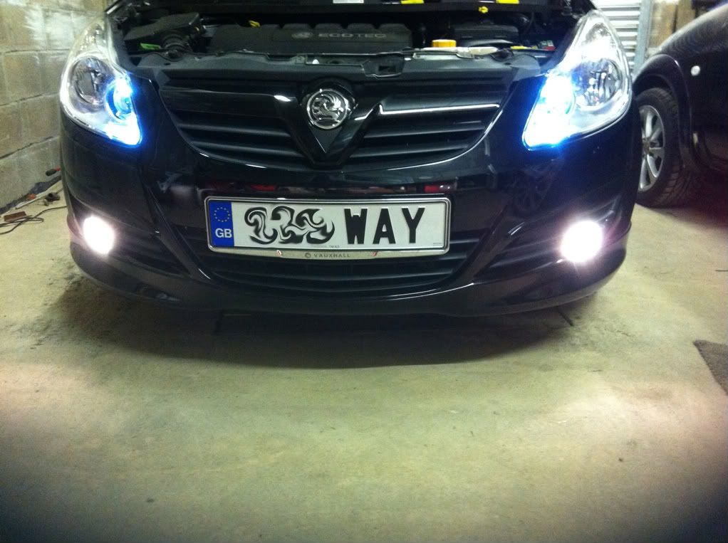

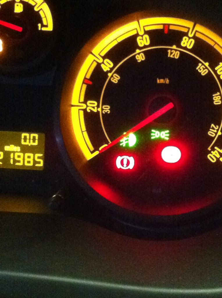

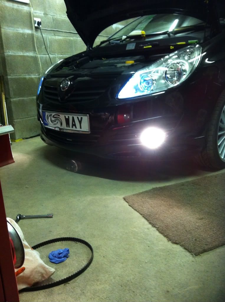

and after taking the bcm module plug and fuse box apart and fitting the pins in the plugs and soldering them to the wires they work :yippe:
its not a job for someone who hasnt got the skills to do it very small pins to be fitted and a bit of dismantling of your car

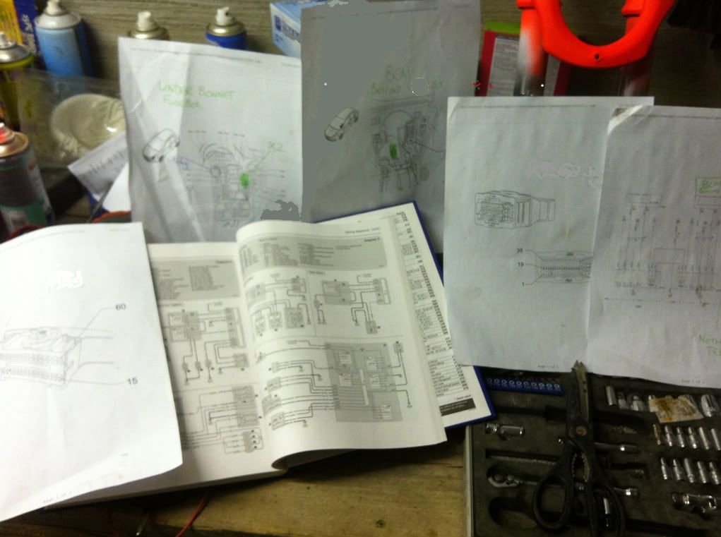

I started with a little bit of reading and working out how to do it
FINAL RESULT :biggrin:
