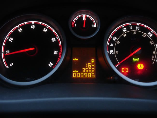

As you all know the dials look like this:
Well to start you need to press the button which resets your mileage so start off by pressing it in sequence: 1,2,3,4 and hold! hold the button in for 10 seconds MAX:

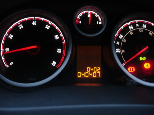

(As you can see ive pressed in the button 4 times but im holding it in)
The dash indicator should come up with lots of random numbers like this:
Well now thats basically it
Press the button in 5 more times no need to hold it in this time.

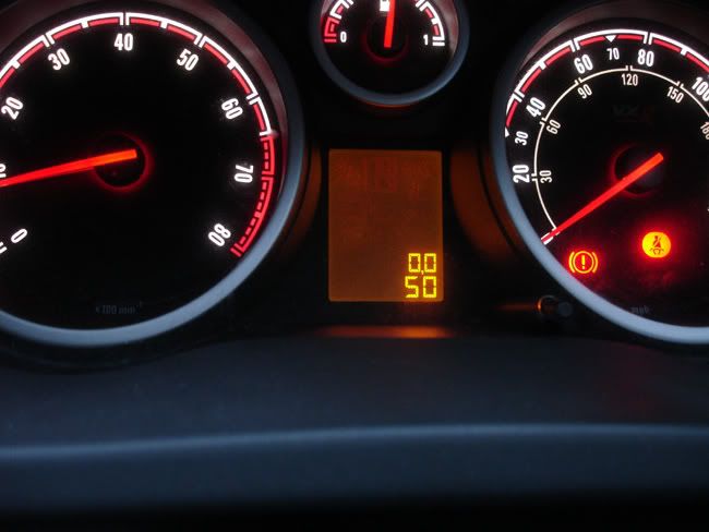

Once you have pressed the button 5 times this is the screen you should have on display:
As you can see in the picture above the 100 means ive got the lights on and my engine temp is 50.
This picture i have my lights off but still shows the engine temp
