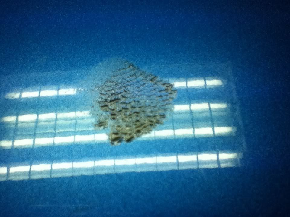

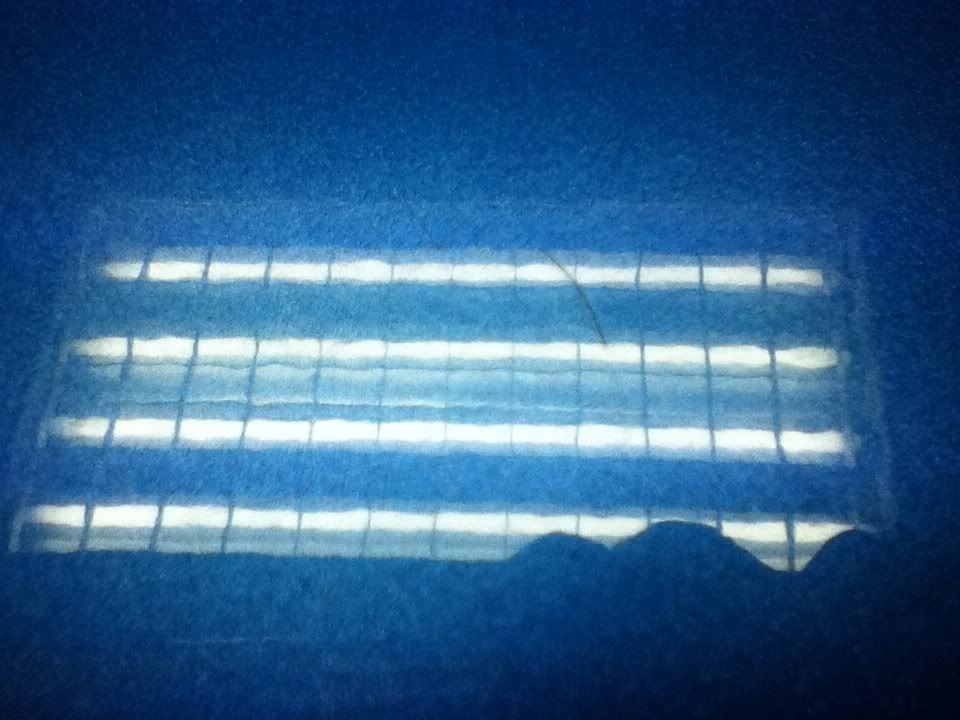

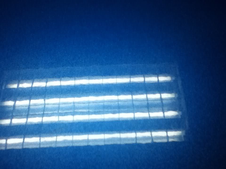

Ok i though id run a tutorial on how to remove scratches from you paintwork, firstly find a scratch lol

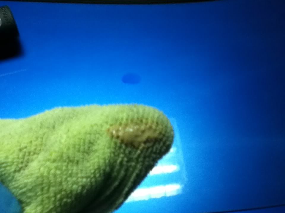

With a touch up paint of your car brush some over the scratch and with ure finger rub lightly in a circular motion till you begin to feel the paint harden ( best wear rubber gloves)
Then with some T-cut on a cloth dab this over ure painted scratch

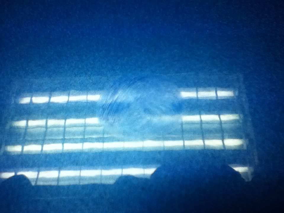

Leave this on for maybe 30 seconds or so, then begin to lightly rub the T-cut in a circular motion
Until the painted patch fades, should look like this
After this stage just then polish and wax and hay ho scratch has gone :) hope this helps folks
