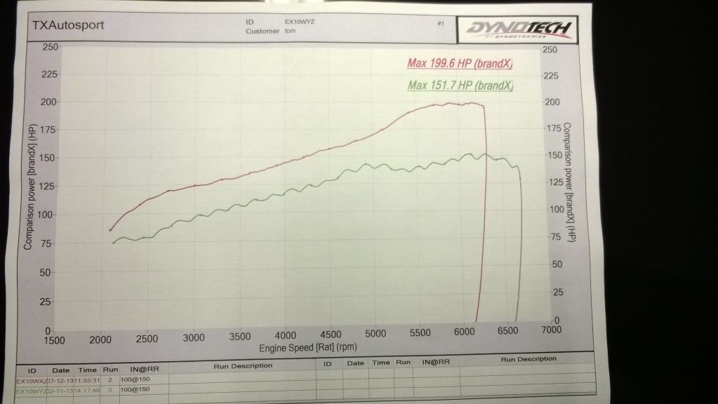

So I know some of you have seen A16LER dyno graphs before, coming in under powered, and very unsmooth lines. Is it the map, or the cats or what?
Well this is a 2010 Corsa VXR with the standard A16LER map, then remapped with a standard Z16LER map.
Quite a difference, considering both pre 2010 and later were sold as 192PS cars :D

Not as easy to convert them to Z16 or anything but yes they appear down on power.
