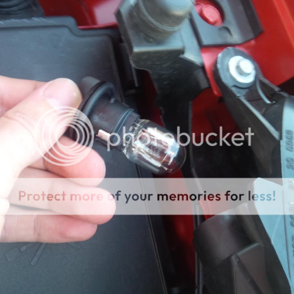

At the top of the headlights is the DRL bulb. The cap should be locked in place, this twists clockwise roughly 20 degrees. It can then be pulled out
It may be a little stubborn, so give it a little wiggle, and the cap and bulb should come out, and you can easily and naturally pull it towards you. The bulb should then pull out of the cap, and can be replaced with the new LED bulb. This bulb is considerably longer than the one you have just removed.
