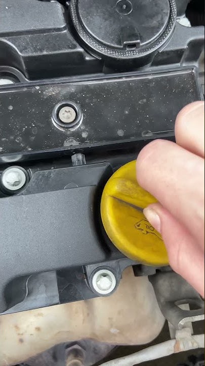

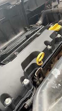

Yes Everton I have replaced my rocker cover cause I think it was faulty unless I have also sealed it incorrectly or the part is faulty?
Discussion starter · #33 ·
I have a suspicion it can be the rocker cover or I may have an air leak or a blockage somewhere the rocker cover is not expelling air nor is it sucking air in, when I take out the oil cap there’s an insane vaccum

Noticed today it pops on idle after engine is warm
And a strong vaccum
What made you replace the rocker cover in the first place?

Did you get any paper work stating what was deemed as "faulty". Because a rocker cover can only be "faulty" in so many ways: 1) Leaking gasket- but technically this is the gasket failing you wouldn't replace the actual cover for this so this could be ignored. 2) Physically damage to the plastic 3) PCV membrane built into it is damaged.
Was this making the noise before the rocker cover replacement? If not, how long after did it start making the noise after repair? Also quick tip the videos you are doing are great, but leave the phone recording longer on some, try get 30 - 60 secs so can get a good watch [emoji1360]
